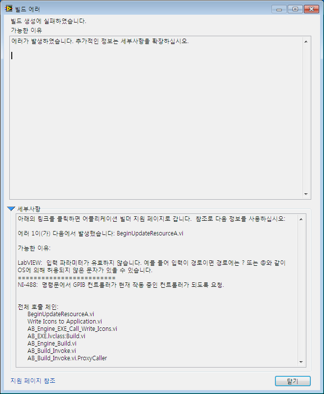

"The Build was unsuccessful....Error 1 occurred at BeginUpdateResourceA.vi"
I looked for the file named "BeginUpdateResourceA.vi", but I couldn't find it. The file is not in the project of course.  The error occurs only at my customer's system.
