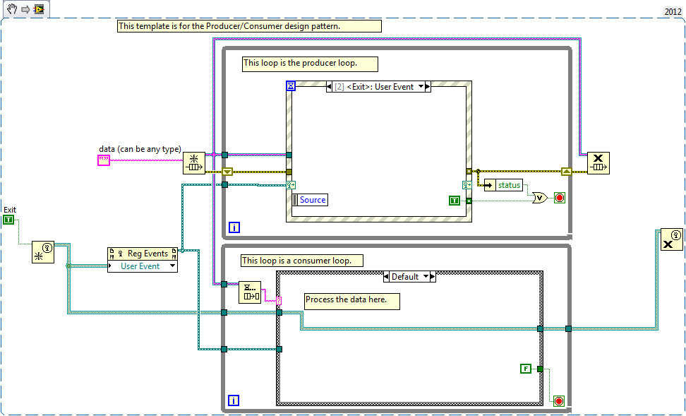

Just use a User Event to have the Consumer send a message to the producer and properly shut down, your queue type may need to change to account for Messages instead of just CAN Frames, but this works robustly..
Open up this snippet in LV or see attached code..
