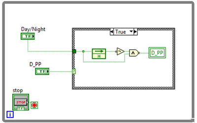

I have a larger design (not my own) that I'm attempting to modify. I am VERY new to Labview. I needed something that would toggle back and forth on a false to positive edge.
I used some edge detection logic that I've seen suggested in some other posts to try and do that inside a case statement that used what I think is a local variable.
Logically, it seems simple enough, but it also seems that at times either it does NOT toggle, or perhaps it toggles 2x (the result being the same). The input is from "inside" the larger project, so in a hardware sense, it would not seem to be asynchronous (to everything else in the project, so to speak) at least to me.
However, I will admit to NOT understanding race conditions in Labview, and maybe that is the issue here.
I've given up trying to use this approach, but I am still trying to use the edge detector for another purpose (being driven by the same signal) and am worried that since I don't understand why this occasionally had a problem, that my use of the edge detector is also doomed to fail on occasion.
Any explanation why this case statement toggle approach seems to fail, especially as it involves edge detection would be GREATLY appreciated.

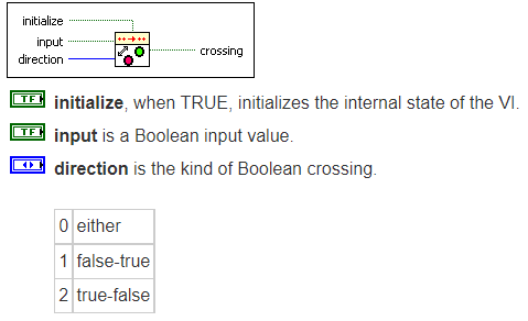

Of course we also have the boolean crossing tool. No extra code needed. 🙂

Good call on the use of the built-in Boolean Crossing function.  Both more clear and more versatile than our raw code.  Same startup behavior too -- edge detection output always False on first call.
-Kevin P

I went from this (which fails to switch properly at times):

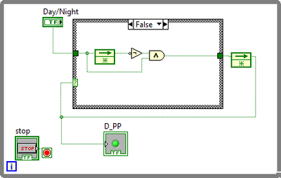

To this (which seems to be more robust):
Note that LV added the feedback node when I wired the output back to the input.
This leads me to believe that my original attempt caused a race condition whereby both the T and F cases were evaluated in the same loop iteration meaning that D_PP switched twice when it should have only switched once.
With the added feedback (delay), that's impossible, I think.
Thanks to everyone for their time and effort - I feel good about solving the problem.
