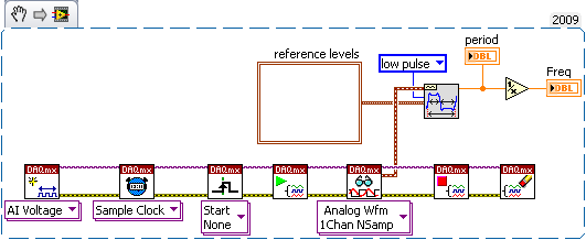

For pulse and frequency measurements:  The PCI-6229 has analog inputs.  Use an AI channel to capture the waveform.  Then you can use the Pulse Measurement function to find the period and frequency.  Since your falling edge is much faster than the rising edge, use the low pulse selection as shown below.  You can set the voltage levels for high, mid, low, according to your actual waveform.  See the snippet below.  You will need to fill in the specifics for the DAQmx functions and add Error In and Error Out.  Hmmm, the reference levels cluster elements (hi, mid, low, absolute/percent) did not show up.  More problems with code snippet.
For reference levels, you can select percent enum and set hi=90, mid=50, lo=10, or you could select absolute and enter values in volts, hi=3.7, mid=2.5, lo=0.5.  try both to see which one works best.
20003i47C0D56A15946CF6
To count a number of pulses in a certain timeframe, you could use the same DAQmx method to acquire the signals, then process the waveform's Y data to count each negative going pulse.
