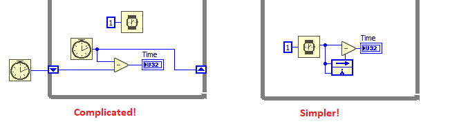

@Pablo_Novadep wrote:
Your tip is amazing, only 2ms in each loop!! Thank you very vey much. I modified your example to what my application has to do, my image works like a fifo stack, that's why I have to rotate the image. I attached my example to see if you think it is efficient or not. I have measured the time in each iteration and it is 70 ms.
 Why do you think you need three time primitives to control and measure the loop rate. One wait is sufficient, it will give you the tick count for free 😄
