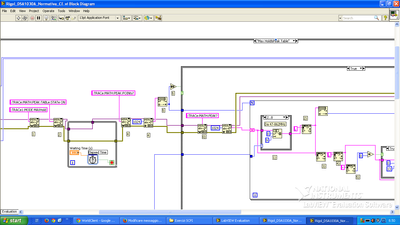

hi sorry for the delay... attached there is the VI..
the problem is in the Max Hold&Peak table as shown in the immage:

Hi inuyasha84,
I believe you need to reset the elapsed time express VI in order to make it start counting at 0 again.
If you hover the mouse over the VI, you can see that there is an input node for you to reset the function.
