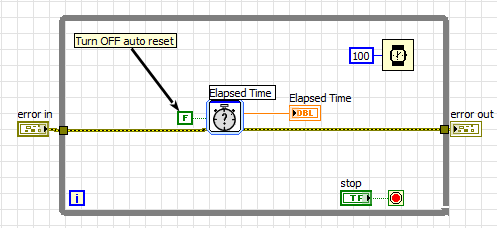

Why not use the Elapsed Time Express vi? (turn off auto reset)
=== Engineer Ambiguously ===

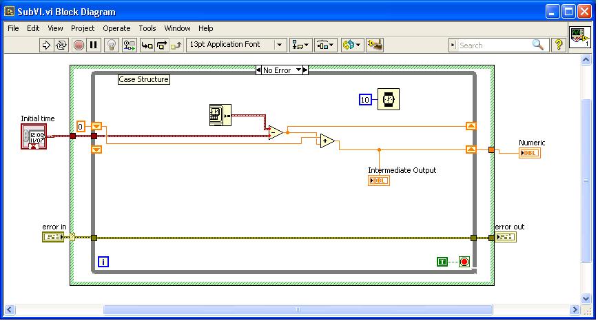

Hi, hiNi,
I think I kind of understand what you aretrying to do. I think the "initial get time" should come from "main.vi" instead of "sub.vi" so that you capture the start time only once at the beginning of main.vi loop.  Also, in side your subvi I suggest you just use the subtract function.

I think the shift register you have inside the sub.vi does not necessarily hold the last value you have in there everytime you call it.  Two possibilities:
1. Everytime you leave the sub.vi and go back to main.vi,"first call" think you are call the the sub.vi for the first time again
2. Or shift register(for time elapsed) gets reinitialized every time you leave the sub.vi.
so every other value is not correct.  If you want to increment or keep any value in a variable they should probably be in "main".
Naicha
