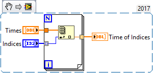

I feel like at some point in the past you wanted time values rather than indices of the threshold crossing points - to get these, simply using the index to index the array of times. Since the Indices output is an array, use a For loop with autoindexing inputs for the indices, and no indexing for the time values.

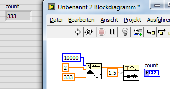

Hi ki4,
using that PeakDetector is quite easy:
When you don't get the expected results then you need to debug your VI:
- do you read the expected waveform from DAQmx?
- does the PeakDetector give the expected result with the waveform you got?
- did you check the error output of those PeakDetectors?

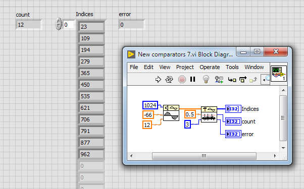

I'm sorry, I used the wrong name for the function in my image. I used ThresholdDetector (instead of PeakDetector as I wrote in the message) in the same way as you did in your last VI…
What "does not work" when you use ThresholdDetector? In my little image it works as expected!

Hi ki4,
My signal is sinusoid waveform [-2V; 2V] , I detected well by my DAQ BUT the threshold detector doesn't count all the threshold.
My little VI creates a sine wave with an amplitude of ±2, with lots of periods.
The ThresholdDetector detects them all:
SOOOO,...
What is the difference between my sine wave and yours?
