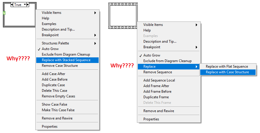

Elegant Way to replace a case structure with an event structure
Since an Event Structure is like a Case Structure in some regards, I would think there would be an option to Replace With - of course with some modification of the triggers.  The issue is I would rather not delete the
content of my case structure as this would be like starting from scratch.  But  I can't find a way to do a replace with between these two structures

Yes, I agree it would be useful to do a simple 1:1 conversion of the frame contents to the new structure. Cleaning up later would still be easier than to start from scratch. All the code and tunnels would still be in place. A good start!
(OTOH, we have completely useless tools, such as the capability to convert a stacked sequence to a case structure (or vice versa). I can only imagine the mess that would create, especially if there are many sequence locals. 😮 Has anyone actually ever used that?)
