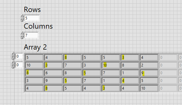

Here I create a 2D array of random numbers with 5 rows and 7 coloumns (suppose).
The output I'm looking for is a 1D array of elements [8, 3, 3, 10, 8, 5........] and so on. I hope you understood the meaning of element at every 3rd position of iteration.

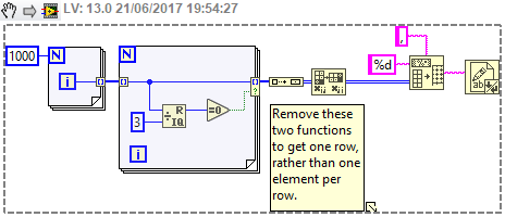

For a loop based method, you should Reshape the array as already shown, then you can read the method I gave here yesterday: Saving data after specific increments. That link had a slightly different goal, but still wanted every third element from a 1D array. Hopefully it's obvious which parts you should delete if you're not writing to file 🙂
The snippet is below, but the link above has far more detailed explanation of why I used those functions. You'd want to change the input to the top of the Quotient and Remainder function, since this example was looking for multiples of 3. You want 3rd elements, so use a value that increases by one each iteration. Hint: You don't need a shift register - it's already on the diagram 😉

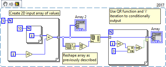

I did? Below is my modified snippet, doing the actual task here - I had thought people were avoiding "ready-to-use solutions" at GerdW's suggestion, but it seems there are several to choose from now.
Nice reshape though... very slim. I wonder if it's slower though - does the Reshape Array just alter dimension sizing, whilst your for loop copies into a new array? I don't know...
GCentral
