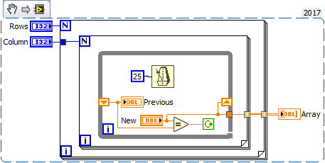

I am new to LabVIEW, I go through certain LabVIEW online free tutorials and videos. I am trying to to do, in front panel user tell the dimensions of the array, then he inserts each element one by one and program should wait for user next value, to doing so I used two far loops to cater row and column and while loop to wait for user values.
Problem is it just get one value from me and then program stops and shows the array with only last index number new element. I hope I explained my problem well.

wh do you need all this stuff to fill a 2D array with user input?
Use autoindexing!
(You should rethink the inner while loop: it might be annoying not being able to input the same number for the next element…)

The problem get's easier when you get to know (and properly use) the event structure.
To get to understand data flow, try the execution highlight. That will probably show you why the program stops and only returns one element.

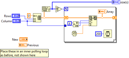

Of course if you want to see the array as it is buidling up, its terminal needs to be inside the loop and updated with each iteration. That's also where a shift register comes in to hold the data across iterations.
Here is a very simple draft that shows you how to interactively fill an array inside a loop. Note that one FOR loop is sufficient, no need for Aztec pyramids of loops. 😄
To adapt your code you would add your inner polling loop. Personally, I would probably use a dequeue in this loop and use a separate loop with an event structure to enqueue a new value (and spin that loop to add an element). Then you also need to decide how to proceed once the array is filled, etc. A good playing field to learn 😄
