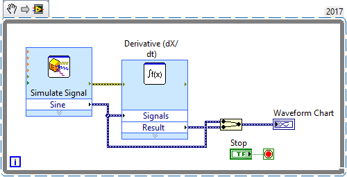

My apologies.  I just now opened your code, threw out almost everything except the Dreaded DAQ Assistant, the Filter, the Select Signals, and the Derivative (mind you, I've never used any of these Express VIs, except a very brief "trial" when the Dynamic Data Wire was first introduced, and I found it so tedious and difficult that I learned all about Waveforms ...).  I then looked for where the assumed (wrong -- never assume, rather carefully read the Help document) Calculation Mode input was placed.  Sigh.  It's not there.  So much has been hidden from you -- it can even confuse "someone who should know better" (like myself).
I apologize for leading you somewhat astray and for making a mistaken recommendation for a feature (Express VIs) that I don't use.  So I did an experiment -- I created a Sine Wave generator and fed it through a Derivative, plotting the result (and using all Express VIs).  It worked just fine.
Simple Derivative TestSimple Derivative Test
Your VI is much more complicated, and has many more "moving parts", most of which are not accessible to me.  "When in doubt, simplify" -- take pieces of your code, see what works, try to isolate what "breaks", and then test that separately to try to understand the error.
Bob Schor
P.S. -- the Attachment is a LabVIEW Snippet -- drag the PNG file onto a blank Block Diagram and the code with automagically appear.
