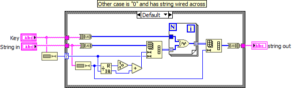

Well the simplest form of encryption you take a bit stream and XOR a repeating "key", the longer the key the stronger the encryption.
Decrypt is the reverse, XOR the key with the encrypted data stream and the output will be the original data.
Here is something I did a long time ago to encrypt and decrypt a text file, I am not sure how you would work the USRP into it...
That uninitialized shift register seems like a bug to me. It will give proper results, but every time the VI is run, a little more memory is used an not returned.
Message 6 of 30
(9,019 Views)
Exactly. In fact that loop should be a FOR loop (The total number of iterations can be fully determined form the sizes of the inputs before the loop starts!) and we could just autoindex into a 2D array at the right boundary because the reshape operation will accept that too, giving the same result.
Most likely it could be made even more efficient by XORing in place, section by section.
Message 7 of 30
(9,006 Views)
@altenbach wrote:
Most likely it could be mode even more efficient by XORing in place, section by section.
I think the idea was that the array would grow if it's too small, and recycle the old array if it's big enough. That's a valid concept, and the shift register does the trick. Except the array also grows if it's big enough, and keeps doing that forever. So there's a leak.
Also, Key can't ever change, but still needs to be given each cycle.
Calculating and a for loop might indeed be easier on the mind...
I try to avoid while loops for algorithms like these. Things tend to be overlooked. For instance, what if Key is an empty string? You've got yourself an infinite CPU burner...
Message 8 of 30
(8,994 Views)
Yes, we need to protect from zero-length keys, but the math is especially simple (in=out) in that case 😄
Here's what I might do. The loop can even be parallelized, but I doubt it would make a big difference. (Same code for encryption and decryption.)
