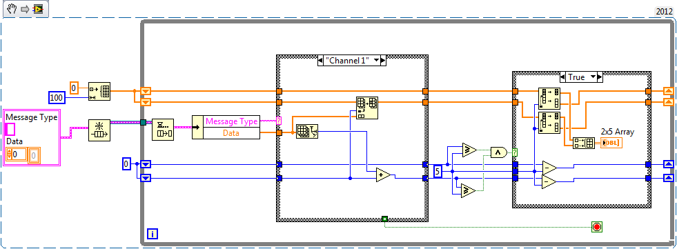

This is some very strange code. It is also pretty inefficient. A better way would be to use a single queue for the consumer and create a simple message. The message would be a cluster containing a message type (string or ENUM) and an array. The producer would send a message corresponding to the channel or whatever is driving your choice to determine the row with whatever data is remaining. The consumer would get this message, immediately dequeue it and process it. It would update your 2x5 array when you have enough data from each source. In addtion, the consumer will buffer any data so you do not lose any data that had arrived earlier. Here is what the consumer would look like.
You will also notice that I have add a Stop message (not visible in the snippet above) to control when your consumer should exit.

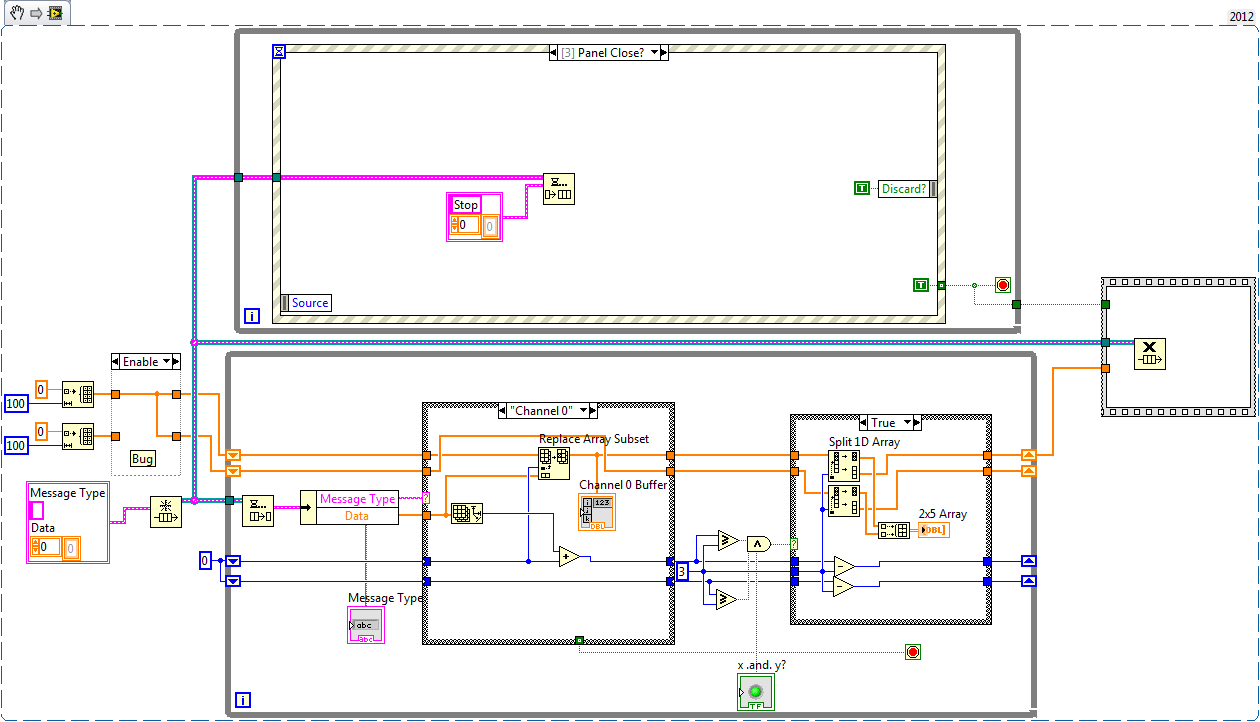

I modified your VI a bit and included the producer loop. I also made it event driven which is much better than polling like your code. In addtion, you actually uncovered a bug in LabVIEW. I didn't execute the code before I tested. It turns out that simply forking the wire after the Initialze Array doesn't work. The compile has a bug in it which I will submit. The work around is to have two Initialize Arrays, one for each shift register. It now works as expected.

thanks again!
I actually just got it working by initializing the array twice!
But the event structure is much better than polling.
I just get an error when trying to run the code: the NewVal in cases 0,1,2 seems to be invalid.This is the error:
Event Data Node:Cluster is invalid or empty.
The input to this Bundle or Unbundle function is not a cluster, or is a cluster with no elements.
