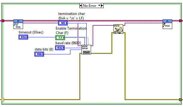

I attached a picture of the vi, exposes the VISA, configures the port, then puts it back using the Write

Are you running into any issues with the code you have? It shouldn't be a problem, assuming you have four copies of Class A / B each configured with a different VISA resource. LabVIEW classes are by value, so each class wire will hold its own private data, independent of other instances of the class.

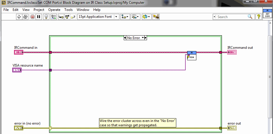

The innards of the Set COM.vi

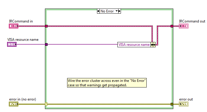

nathand: What you are saying is I should change the Set COM Port to something like this and just unbundle in each of the vi's instead of the accessor:

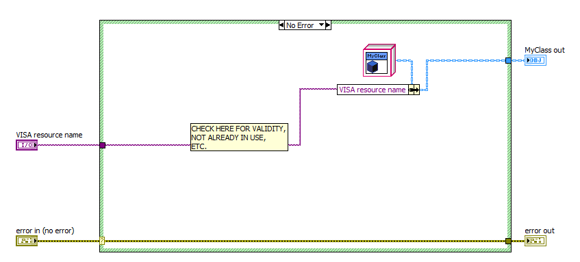

You could use a class static variable (a privatly scoped FGV, for example) that maintains a list of all currently used VISA resources.  Whenever you construct a new instance of the class (within the constructor / initialize VI), add the instance's VISA resource to the list.

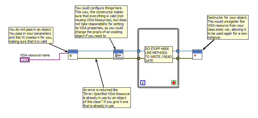

nathand was suggesting that you have a constructor / initialization VI that you use to instantiate an object of your class.  Instead of placing an object constant on your caller block diagram, always call this VI to get an object.  This VI would handle all initialization tasks and take in required inputs - i.e. take a VISA resource as an input, configure it, check the static list that I suggested, and then return the fully-initialized-and-ready-to-use object.

Here's an example of what a caller block diagram might look like:
Inside the constructor VI:

There's no need to repackage the VISA resource into the class after each use, since VISA resources are references to real hardware.
