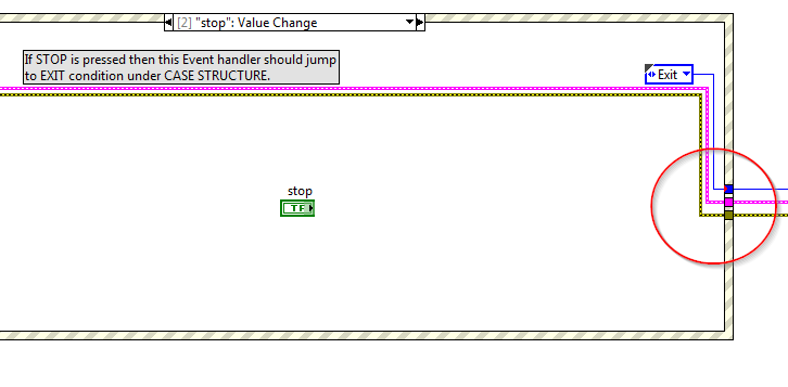

hi,
  1. One of my enums (type def) is not updating the case structure names. I found a dot resembling a probable error in the event structure,
  2.  I had created the constants from the enum before I made it a typedef. Therefore, I made new constants from the typedef and replace the original ones. and still the case structure doesn't update.
How can I solve this ?
also, I Have one state machine inside another. Is this right way to program ?
2013-06-09 11_06_13-Motor-UNI_Directional(SubVI) Dev 1.vi Block Diagram on ImagingProject.png

Somewhere in your code, you either have the wrong typedef, or didn't replace a control with the typedef. You must not have replaced them all. I am not sure if there is an easy way to search; you may have to go through all the cases.
