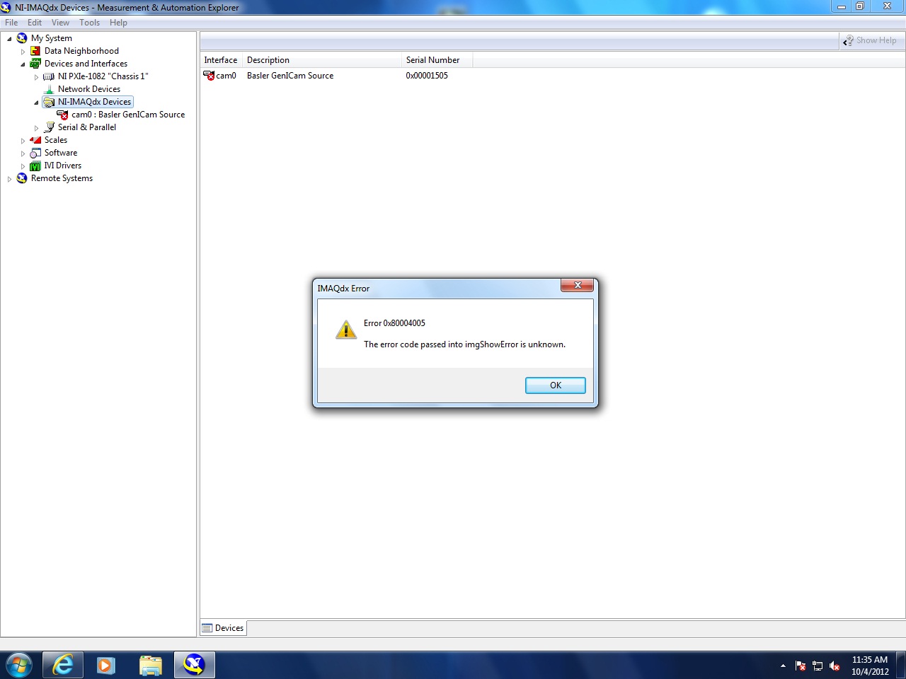

I am working on Labview for small project which is on Chasis NI PIX 1082..
It has NI PXI 6229 which is connected to the camera *(Basler GenIcam ) from "connector 0" .
I was getting error 0x80004005 imgShowError from long time.
I updated eveything at MAX but still I am getting same errror.
How I can make it to work?

When you disconnect the camera from the framegrabber, do you still see the GenICam source in MAX? If so, it would appear that there are still some Basler software components left on your system. Also, when you right click on the camera in MAX, do you get the error message, or are you able to access the context menu?

The camera is disconnected by the Ethernet Cable from NI 8234..
I can still see the BaslerCam in MAX as you can see I can't access anything when I right click on the camera.
Now you can also see the list of the software installed on my systems..
