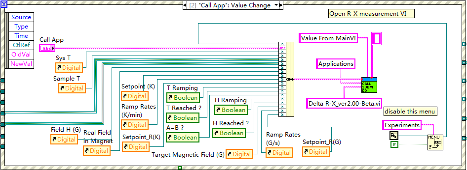

Actually, I had the kind of  check before calling the  "Call_Subvi_Do(variant).vi"  Please see attached snapshots.
check VI status before calling it1.PNGcheck VI status before calling it2.PNG
