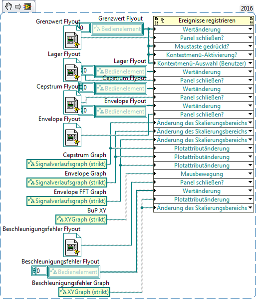

Also, I'm having another "invalid reference" error after the switch to 2016 which may be related or not:
I have a register for events node in my main vi that I feed only ref constants as placeholders (see snippet below, sorry for the german). It returns error 1055. So do follow up nodes where I feed valid references into some of the placeholders - presumably because I haven't replaced all the invalid references at that point.
This too used to work flawlessly in LabVIEW 2015 SP1.
The array constants seem suspicous (but maybe I just don't know the intended behaviour properly): If I click them and follow the class hierarchy I see they have "Bedienelement" (presumably "control") and 3D waterfall checked at the lowest level. If I switch that to say, boolean in the same level it has only boolean checked. If I then switch back to "control" both control and 3D waterfall are checked.
Additionally, before I went through this procedure once the bd constants only read "Element" not "Bedienelement".
