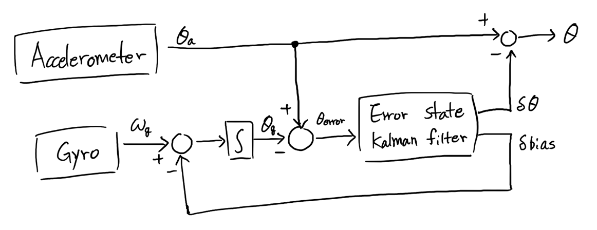

I would like to measure true degree from IMU sensor by using indirect kalman filter(IKF) on Labview.
I can calculate error of angle and error of the bias of gyro from indirect kalman filter as below image.
However, i can not remove the bias of gyro despite using error of bias calculated from IKF like a below image.
I would like to know how to use IKF's output.
Please let me know if you have any solution.
