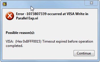

Error -1073807339 occurred at VISA Write
Everything was working perfect, and then suddenly out of no where this happens.
I went through various posts and advises but still stuck up with this problem.
Could some one please help me out of this problem.
Attached is the code to run a simple write to LPT program to check. If anyone use parallel port with VISA. Please run the program and tell me if you get any errors like the one I have ...

Hi abikutn,
It looks like you are attempting to write too quickly to the device. Include some sort of "wait" in the loop. Try the "Wait Until Next ms Multiple" subVI.
