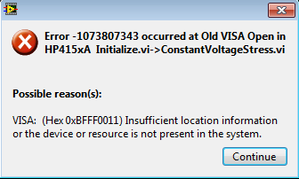

Hi all,
It seems that the error is common, I am using HP4156A controlled with a VI on Labview2013 connected together via a GPIB-USB.
I am getting the following error :
any help ?
Thanks !
(22,928 Views)
The old VISA Open is a holdover from the original VISA implementation around LabVIEW 4. Delete it and use a normal VISA Open from the palette and a regular VISA Resource Name wired to it.
