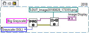

And it certainly is supported!  The third choice for a Buffer Type is "Grayscale (Sgl)".  You failed to post your code, so I can't tell what you did, and can't explain your error (if, in fact, there is one), but this Snippet should read and display your data file --
