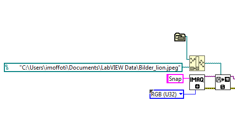

Hey!!  i'm getting Error -1074395995 occurred at IMAQ ReadFile.
I don't know why it happens. could someone please help me. Here is a picture of my Code:

Hi moidrissou,
why do you use quotation marks in your file path constant?
And what kind of path do you expect when adding a full path including "C:\" to your AppDir path?

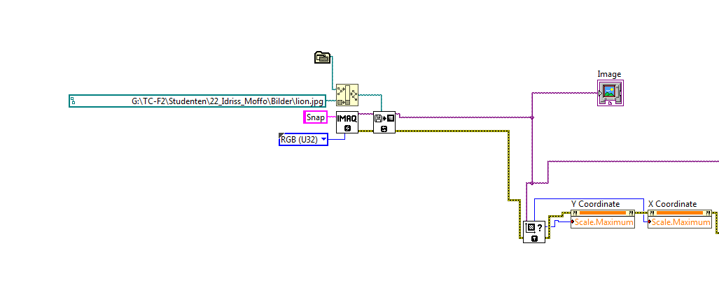

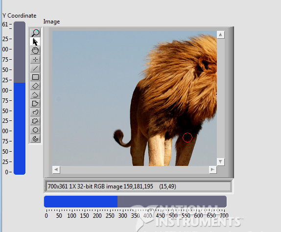

Hi GerdW,
i first want to thank you for your reply. sorry for the quotation marks, it was a mistake. i changed it but i still have the same error. can you please tell me if the path i generated is ok. i want to Read an image, which i saved in this path. the picture is saved with the name lion. Unbenannt.PNG

Hi moidrissou,
Well, you still try to add a full path to your AppDir!
Why don't you get rid of that BuildPath function? The path to your image is defined just from your file constant!
No I can't: you only added an image instead of your VI. It's hard to debug images with LabVIEW…
Why don't you put a probe/indicator after BuildPath to check that path on your own?

here is my code
Message 5 of 11
(8,539 Views)
