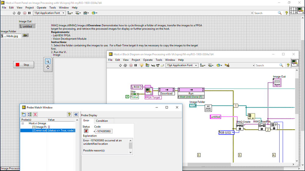

@GerdW wrote:
Hi pattern,
all you presented so far is that error message with some probe values I used to explain that error to you.
But you failed in presenting any substantial data:
- Which path do you use as input "Image folder"?
- Which target do you use to run the VI shown in your images?
- What is the content of that small VI named "Get image path"?
- Why is there no error output on that small VI?
- Why does it output an empty array of filepaths?
- Why don't you react on that wrong (?) output of an empty array?
- Why do we get just images of code - instead of real code? (How would you answer when someone is asking for help on problems of C or Python code with just showing images of that text?)

Hi pattern,
now I miss the subVI named "Get Image Paths from Folder", maybe because I don't have VISION installed…
Btw, may I know why "PET" path is invalid?
Because this is no valid path for Windows. Usually you have a colon and some backslashes in paths…
Your "host" VI is using the path "/c" as default value, which is the C drive of your myRIO target. Are your images located in exactly that folder?
In message #2 you show an image where you apperently try to load images from your Windows PC harddrive: this is something completely different than the C drive of your myRIO!

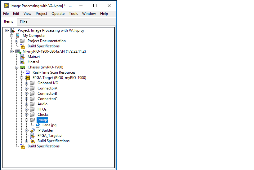

Update: I create new virtual folder under FPGA target and locate the image. Is it like that?
I will run the VI and let you know the result. Thank you

@GerdW wrote:
Hi pattern,
please read the basics for cRIO (and other RIO devices)!
You need to transfer the data to your myRIO! Either "statically" when deploying the project or "dynamically" by creating some host PC to myRIO communication…
Hi GerdW,
I will study that part and do it again. Will come back if I get problem. Thank you for your support
Message 18 of 21
(2,543 Views)
Hi pattern,
No, surely not.
That "virtual folder" is
- as the name says purely virtual
- denotes just a hierarchy in your project file
And the FPGA does not know about files and folders!
When creating a deploy build for your myRIO you can include certain files in the build to be transferred to your target. Please read the basics…
Message 19 of 21

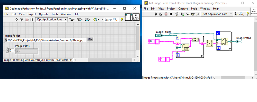

Hi GerdW,
I have try to debug the error but I still stuck on it (get the same error).
This is my "get image path" VI. I set the image folder as shown below. What I missing? Please help me..I have no idea how to copy the image to the FPGA target. Smiley Sad
Error2.pngThank you
Message 20 of 21
