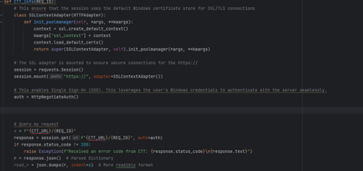

I have a script with python that connects with an API and gets some information. When I run this script with python, it runs fine without errors.
Once I run it using LabVIEW I get the error 1671: Python returned the following error: <class 'Exception'>
I am guessing that the problem is with the Exception. For some reason when I run the script from LabVIEW I get an error back from the API session. Does someone know more about this?
The two required variables here: CTT_URL is given by the python code (it's hidden for data protection) and REQ_ID is an input parameter that in the LabVIEW code is a DBL. Would that be an issue? I tried that the REQ_ID in LabVIEW was a string and an integer , but then the code is running indefinitely and I have to stop LabVIEW using the task manager.
