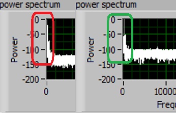

If you haven't solved your issue by now, can you zoom on low frequency in your power spectra graphs. Difficult to see but it looks like you have either a big DC or tone at frequency lower than 159 Hz present when it fails.

Actually I am pretty sure you are having IEPE settling issues. The IEPE supply takes several seconds to settle (DC signal settling through your channel AC-coupling) and that happens every time you select/activate a new channel for the very first time after power on.
DAQmX Help says:
Changing the IEPE excitation level may cause transient voltages to appear in the signal. NI-DAQmx does not implement a delay to allow the signal to settle. Therefore, after changing the IEPE level and committing this change to the hardware with the Start function/VI or the Control Task function/VI, you might add a software delay to allow the signal to settle before proceeding with your application.
In your VI you are using a value for the time to settle parameter of 200 ms. Try 2 to 5 s (experiment with that value by looking at the exponential DC decay of your time domain waveform. A good target could be to have a DC offset at the beginning of your acquisition that is less than 10% of your 159 Hz tone amplitude)
