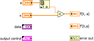

Rather than complicating the issue with my big code, I made a small example that has the same issue. I still think that my initial condition has something to do with the problem, though I created one initial condition to match my one parameter a. I would appreciate it if you don't mind looking at this simple VI I created, which is pretty much a linear equation, just using the nonlinear fitting format because that is what I am struggling with.
(2,304 Views)
You are missing some basic understanding of array operations. If you multiply two 1D arrays, it will be element by element. Your model just multiplies the array of parameters with the array of x values, but since there is only one parameter the shorter array wins and the output will only have one element.
If you want to multiply each x element by the first array element of the parameters, you need to index that out first.
Now everything seems to work just fine:
