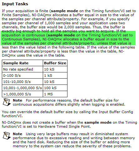

Read this blurb about the DAQmx Timing VI.  Make sure you understand how the buffer works for Continuous Samples.  You'll need to make sure to read samples fast enough to keep the buffer from overflowing.

Regarding your original question, I'm guessing your issue stems from the fact that you have set the device to acquire 85k S/ch/s into a buffer but you are only reading 2500 samples per channel from that buffer to analyze.  Your read loop would have to execute 34 times per second to keep up with the device.
