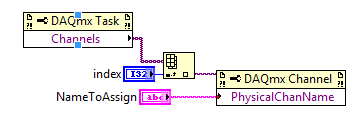

@aputman wrote:
@JÞB wrote:
@aputman wrote:
Edit: Nope this isn't it.
You forgot to set Active Channel first.  Other than that you should be golden.Smiley Wink
Nope.  I tried that already.  PhysicalChanName is the device and channel name (i.e. dev1\ai0), not the alias that the OP is looking for.
Give this a shot
Message 6 of 22
(6,086 Views)
I tried that as well. Reading that property of an existing task returned an empty string, not channel alias.

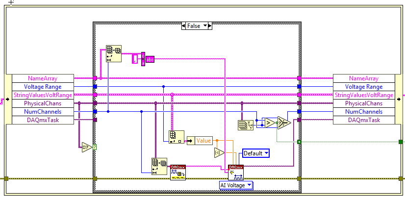

It may have something to do with the task being defined before. I use the same construct except without a predefined task in my programs. See below.Snap2.pngSnap2.png
 It's ugly looking, but it works.
The Eight Ball says "I can't add much to this conversation" Smiley Wink

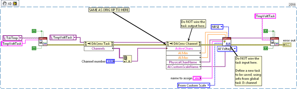

I tried making minimal changes to the original posted code.  I see now that the main idea is essentially similar to what mcduff posted -- use the global task & channel defs to create a brand new task with minimal mods.  Then you save it, overwriting the previously defined global task.
I could have sworn there was a thread from  Bob_Schorr a couple months or so ago that got into pretty similar territory in greater detail.  Can't seem to find it now.
-Kevin P
redefine global task with new channel name.pngredefine global task with new channel name.png
