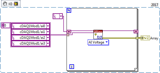

I do not have time to test it out (first day of kids school), but you should be able to loop over all of your channels, adding each channel to the task using a shift register. Something like the following
You will have to add all the parameters like Kevin showed, that I am excluding.

Yes, that should work. This seems like an awful lot of programming is required just to change a channel name. I was hoping for an easier solution.

Well, so you'd just extend the basic idea to the other channels before saving.
The mechanics of it would be that you'd probably auto-index over the array of channels returned from the global task.  "DAQmx Create Virtual Channel" would be inside the loop.   You'd output its task output to a right-side shift register.  You'd feed its task input from the left-side shift register.  The left-side shift register would have to be fed from outside the loop with the right kind of invalid task refnum, which you could likely create by right-clicking the task input from "DAQmx Create Virtual Channel" and creating a constant.
You'll iterate through all the channels from the original global task and make only the needed changes.  (The code will get more complex if the subsets of settings that need to be retained and/or changed can vary from one channel to the next).  At the end of the loop, the task coming out the right-side shift register will contain all the re-configured channels and can *then* be saved.
As mcduff said in his earlier post, it can get a little ugly but it oughta work.  Persistent searches on the site for posts from Bob_Schorr may turn up some more detailed info.
@mcduff: I don't really use predefined tasks either, but I would guess you don't need to close the global task ref because the task was never started.  Since it refers to something "statically" defined in a MAX database, I'm supposing it's analogous to the way GUI control references don't need to be closed.
-Kevin P
P.S.   Looks like I was too slow.  What mcduff posted is exactly what I was describing about iterating over the original channels and using a shift register for the (new) task refnum.
