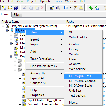

Many ways:
1 Project exploer  select a target (or folder) right-click- New>DAQmx Task  (Silly picture importer this am)
2 From any BD drop a DAQmx Task constant Right click New NI-DAQmx Task> Project...
3 From MAX Create a task and drag it to LabVIEW Project explorer
This works for scales and chanels too!
Now you'll never find those objects on disk!  they show up in the project nicely though because they are really IN the project.  Open the *.lvproj file with an XML editor to see how they live.
4 Use any xml editor to manually create them but that's pointless if you installed DAQmx
The very nicest thing is since they are in the project deployment is painless and your installer will install them on your target.
