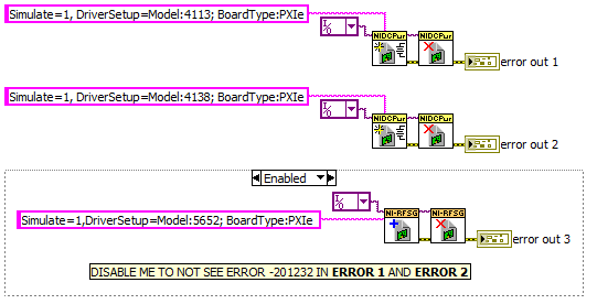

I would like to ask if anyone know why I'm getting randomly error -201232 in indicators error 1 and 2 when calling this NI-DCPower VIs when NI-RFSG is enabled?
Error:
Spoiler
Error -201232 occurred at niDCPower Initialize With Channels.vi
Possible reason(s):
Target storage was altered by another process before the changes could be saved.
Component Name: nidmxfu
File Name: P:\perforce\DAQmx\core\dmxf\trunk\20.1\source\nims\storageAccessors\mxs\tStorageAccessorMXS.cpp
Line Number: 744
Source:
unknown (0): nNIMDBG100::tStatus2::_allocateImplementationObject
unknown (0): nNIMS100::tAttributeDatabase::doesStringTableDllExist
unknown (0): nNIMS100::tStorageSessionWriterWithLock::save
unknown (0): nNIDCPOWER100::compareVersion
unknown (0): pxiCooling_setCoolingTier
unknown (0): LV_niDCPowerPAL_InitializeWithChannels
unknown (0): LV_niDCPower_GetReservedResourcesForDevice
unknown (0): LV_niDCPower_InitializeWithChannels
Status Code: -201232

I created a service request for this (#00958778 19-10-2020). It ends up with a CAR and a workaround.
So, the workaround was to create a simulated device in NI MAX and use it instead of using the "Simulate=1" initialization option.
