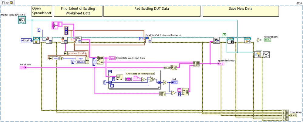

I get the same results with the sub vi that accesses Excel separate from my program, so I've just attached the sub vi here.  I'll also include some screen captures about the two PC environments and the "test bench master.xls" spreadsheet with proprietary stuff removed.
The sub vi basically reads the column of data, pads the new data with blank lines if it is smaller in size then the original data, and then writes the new data back to the spreadsheet overwriting the existing data.

This seems to be a relatively frequent error when you use different versions of Excel. A possible fix I've seen is to clear the formatting before writing back the data. Translated into LabVIEW that would mean in this case using the Excel Set Cell Color and Border.vi (with a transparent background color).
(5,448 Views)
Got it.  Thank you.  This looks like a decent solution.  Not super intuitive, but maybe a little better than ignoring the error, and likely better then digging into the nitty-gritty of NI/Windows interface.  It may be a while before I'm back at the customer site, but I'll be sure to mark as solution if it works.  If it doesn't, guess I'll have more questions.  Anything you suggest checking when I'm there that might help if this doesn't work?  Thanks again!
