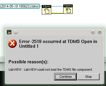

I have LabVIEW 2014 for Linux, and have successfully installed it on OpenSUSE 13.1 with no issues.
The problem I am seeing is with TDMS, I have placed down and "Open TDMS" followed by "close TDMS" provided it my file path to my TMDS File and I see the following error:
I have searched NI.com and google, and what I keep finding is the problem with cRIO. I am running a desktop version of Linux as mentioned above.
Any help or advise would be greatly appreciated.

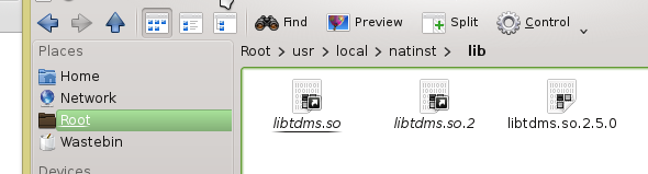

Hey
Thanks for getting in touch with me. I can confirm I have the TDMS components installed and in the correct location.
I will try to reinstall my LabVIEW and see if that helps.

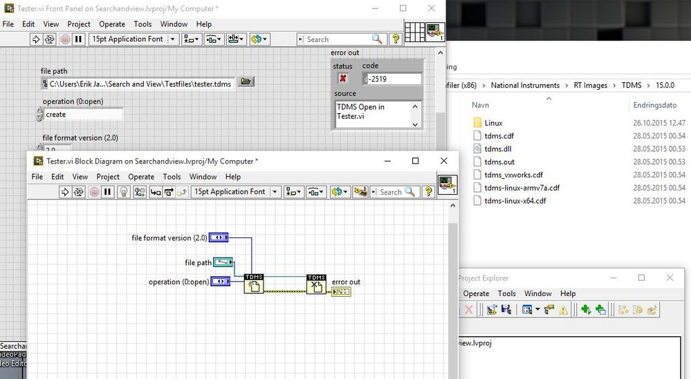

Hello!
I have the same issue. Working on LV15, windows.
I am now reduced to only trying to make LV create a TDMS file, which doesnt work either.
I've tried:

The -2519 error only means there's no TDMS component installed on your machine or the version of the component is not compatible with the LabVIEW (or other application).
Please go to the directory of C:\Program Files (x86)\National Instruments\Shared\TDMS find tdms.dll and right click, choose properties -> details and find out the "Product version" field, which version of the dll on your machine?
Message 6 of 31
(10,660 Views)
Tnx for answering  Yongqing!
The version is 15.0.0 (I guess thats the same version), but for some weird reason the installation is fragmented: One part (with labview) is installed on \Program Files (x86) , and the rest is installed on \Program Files... and thats where the TDMS folder is.
I have no clue to why this is, or how it got there, I certainly didnt ask for it to be installed like this. I've tried re-installing LV.... same results. How can I prevent this from happeneing? And do you think this is the sourve of my error?
