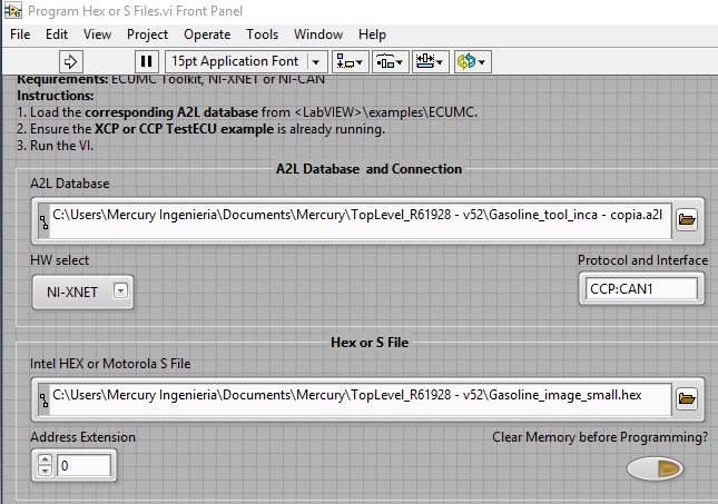

I'm currently working with the ECU MC kit in a third party ECU using the CCP protocol. I've been working withe the examples the kit provides, and i achieved to measure and calibrate succescfully using the "Measurement and calibration application" implementing my ECU and CCP settings and the suitable ".a2l" (generated for INCA software).

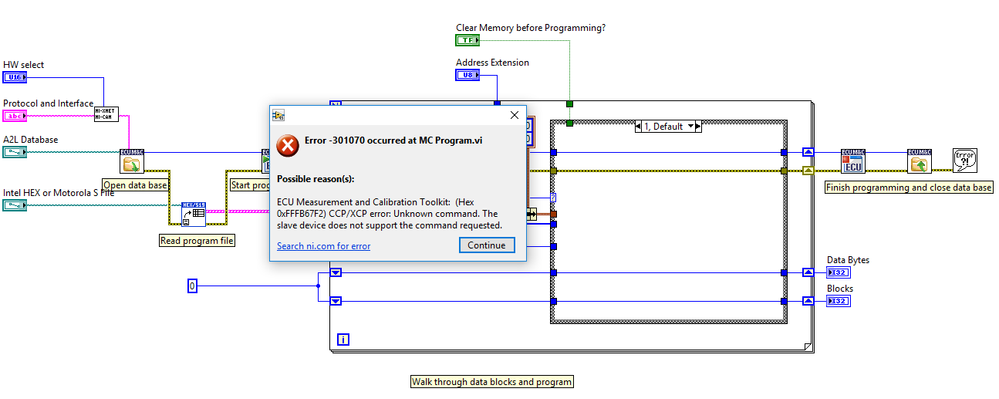

However, when using the "Program Hex or S Files.vi" i got the following error:
image.pngI used the same "a2l" that worked fine for calibration and measuring, and what i wanted to do is reprogramming a ".hex" file into my ECU (i also tried with a ".s37" file but it doesn't worked at all)image.png
¿Could anyone provide me some help with this issue?.
