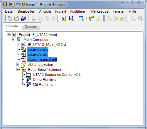

In the error message quote it somewhere says "Installer". I also have this problem now. The app builder creates the DP package in the temp folder, which includes all compiled files, but does not create the full installer. So the part of the error log where it says error -33 is actually nonsense, because the mentioned file is actually added. Worst thing is, the end of the message says "Build successfully created" - huh?

Addtion: the reason is found, but it's not clear, what causes it and how to solve it, so it works as expected.
What did I do? The main VI shall be compiled and for the *.exe it need three files (1x CSV, 1x XLS, 1x PDF) in the \data folder. So I added those three files to the project. It now has one VI and the other three files. When creating the *.exe, it works fine. The *.exe is compiled in the target folder, the subfolder \data is created and the three files are copied there. So the *.exe runs fine,
Now, when creating the installer, it fails when adding the first of those additional three files. If I setup the whole project NOT to use the three additional files, I can create the installer to the end.
Problem is, even if the three files are not added in the build settings for the *.exe and thus not in the build settings for the installer, the installer build process will add them because they are in the project. I had to completely remove them from the project to be able to build the full installer.

For better understanding:
The installer build process will add the three files, no matter if the are used in the build settings or not. I thought, perhaps they are not allowed to be in the same path as the VI to compile. So I created a subfolder and put them there. Then I dragged and dropped them again to the project and this time it compiled the installer to the end.
Conclusion: hours wasted finding this out. There is no plausible reason why the installer builder would fail if the additional files are in the same folder as the VI. Doh!

My code? Why? This was about the location of files when building an installer. The three files failed to be built because they first were in the same folder as the main VI and the project file. When moving the three files into a subfolder named \help, it worked. Just a nasty bug of the app builder, which you simply need to know and keep in mind.

Ok, got it. Your test projects works, yes.
Mine does too, even if I reconstruct the situation from yesterday, when it didn't work. I think this might be coming from the project file and the VIs being saved in 8.5. before, then opened in 2013.
The build log above says something about wrong input data of one of the additional files.
However, it is solved now and actually no one knows exactly what caused this. Thanks for the support.
