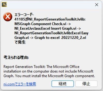

I am new to LabVIEW. I have been trying to write a graph from LabVIEW to MS excel. I succeeded sometimes but most of the time I got the error -41105.
I found this topic, suggesting I verify that the MS Graph component is installed on the computer. However, I don't know how to do it.https://forums.ni.com/t5/LabVIEW/Updating-data-in-a-Word-graph-Office-2010-giving-error-41105/m-p/19...

Sounds like this is a Microsoft Office problem, not a LabVIEW issue.  I can verify that Office 365 (which I have running on this PC) does allow me to embed graphs in Worksheets produced by the Report Generator Toolkit in LabVIEW 2019 without problems.
Bob Schor
(1,236 Views)
Accepted by topic author PuriK.
Sounds like this is a Microsoft Office problem, not a LabVIEW issue.  I can verify that Office 365 (which I have running on this PC) does allow me to embed graphs in Worksheets produced by the Report Generator Toolkit in LabVIEW 2019 without problems.  I wrote a Demo program (which you can find on this Forum) in, I think, 2014 that used the 2014 version of Excel -- it worked then, and the same code (in more recent versions of LabVIEW) continue to work fine.
