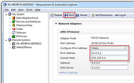

2) Try setting the IP to Static, and choosing an IP.
3) Then try setting the default Gateway to the Computers IP address.

I tried setting the IP address to static and set the gateway to the PC's IP address and no longer get Error 54. So good news! I also tried this with an IP address on the same subnet used by my router and was able to connect, deploy and run the UDP multicast example without errors over my wireless network. Using the UDP Send/Receive example shows no errors on sending and the sent data is also received and displayed as expected.
