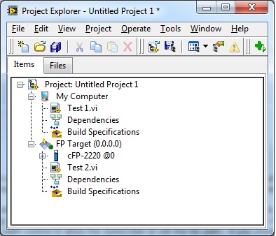

Hey schieb2,
It sounds like this may have to do with where the VI is actually executing. If I'm understanding your setup, it sounds like you have a Compact FieldPoint Real-Time Controller 2xxx that is taking data. Specifically, what cFP hardware are you using? It sounds like you're trying to add a VI that now reads TDMS files and that the VI may have been created under the RT target. If the VI is under the RT target, then it's trying to execute on your Compact FieldPoint controller. Since the TDMS files are located on your computer, it can't find them when it looks for them on the RT controller. As shown in the following picture, Test 1 is running on my computer and test 2 is running on the RT target. You may simply need to move the location of the VI in your project:
You can move the file in your project by left clicking, holding, and dragging the VI out from under the RT target and up to under your computer.
Hope this helps!
--Ryan S.

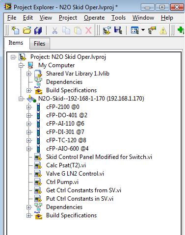

Ryan,
Thank you for your reply and identifying the problem.
Here is a image capture of the project that shows the hardware used. I am editing "Skid Control Panel Modified for Switch.vi" to add TDMS data logging of the sensors and valve positions. I see that the VI is under the RT target, not the computer. I will try moving this VI to under My Computer tomorrow, but I'm wondering if it will affect the functionality of this Control Panel VI. I'm not too experienced with the Fieldpoint Real-time Controller. If needed I can create a subVI for the Control Panel that handles the logging and put that under My Computer and keep the Control Panel VI under the RT target in the project.
Regards, Bill
