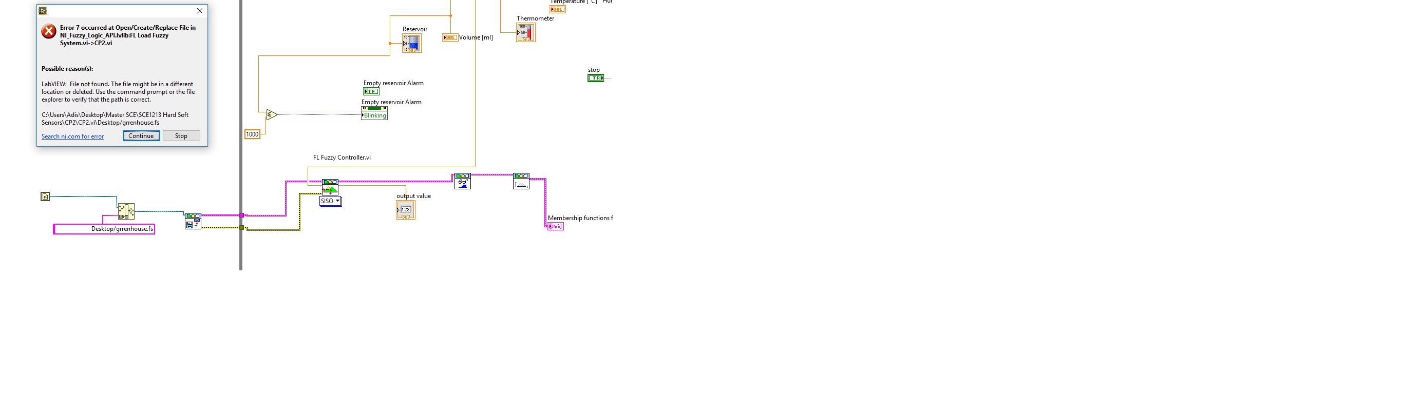

Error 7 occured at Open/Create/REeplace File in NI_Fuzzy_Logic_API.lvlib
I keep getting this error all the time, It seems like the Labview is not able to locake my fuzzy logic system file the so called .fis file. I have tried several ways to create a path to the location where my file is, but it always gives me this error. Its incredibly irritating.It just dosent make sense.
Also what is irritating is that National Instruments explains several places how to do certain things, and when you do them exactly to the point it doesn't work and you get errors.

Hi adis,
Does anybody have any clue on how to make this path correctly????
Well, start by using standard delimiter chars as expected by Windows! You used a forward slash when Windows expects a backslash!
To avoid/minimize problems like this you should use path constants instead of strings: they come with path checking already built in!

I figured out the problem. I removed the blocks Build Path and Current VIs Path and used only File Path control directly into the FL Load Fuzzy System block and baaam it worked. The NI FRuzzy Logic Guide was misleading a bit.

Hi adis,
I … used only File Path control directly
So you used a correct path (as expected by Windows) and your VI is working!?
How is this related to the PID/Fuzzy toolkit and its help?
(Hint: use AutoCleanup before uploading images of the VI block diagram…)

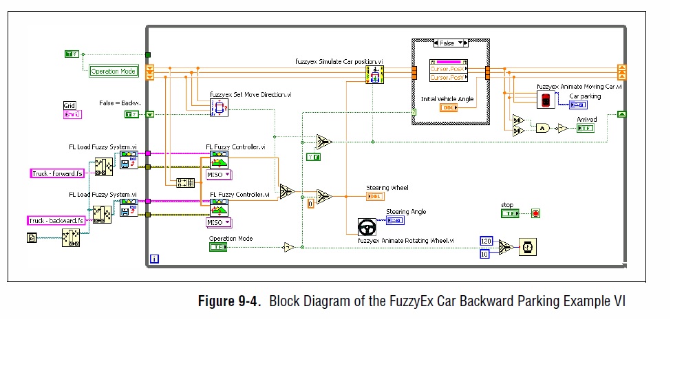

I was using the recipe from the LABVIEW-PID and Fuzzy Logic Toolkit User Manual that I found online on how to make Fuzzy logic controllers. That is why I used this approach from examples from the manual with Current VIs Path block and  Build Path blocks etc which didn't work.
