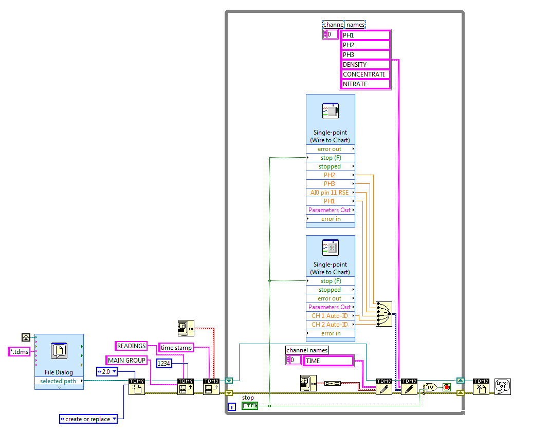

Hi guys.
Thanks for your commenst I could figure out most of the problems but still I have issue with Path directory, can you have a look at my code and suggest any changes

Uhhh... Is it still error 8, or did you change it to error 6?
Now you're creating and then replacing the TDMS file with every single loop. You only need the While loop around the acquisition nodes and the timestamp. And why wire a constant in to the stop terminal?? Use a button.
It's probably best to use the File Dialog prompt to browse for a file or a new file. Your string input doesn't fix the issue from your previous version since you still need to type in "Data.tdms" or something similar.
I'm suggesting something like this:
You might need to add some timing delay to your loop unless those express VIs handle the sample rate already. You also need to wire error clusters through those nodes.

Thanks for all your help. that worked!!!!
