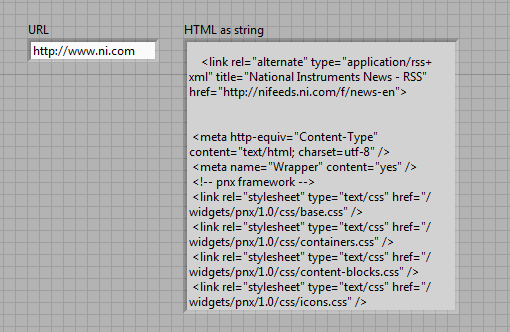

Hello Harry,
Where are you putting the URL that is causing the error? On the front panel using the VI you are referencing, I put http://www.ni.com in the URL box and didn't receive an error as you can see below
Is this what you're doing to receive the error?
