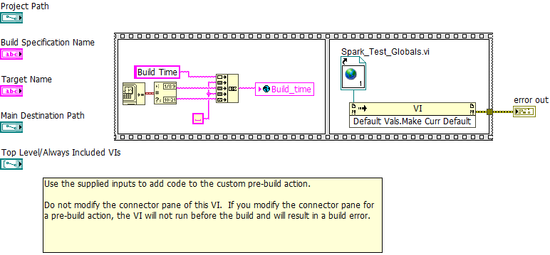

The Pre-Build Actions are a little bit like scripting -- you use them to make changes to LabVIEW VIs before you use those VIs in building an Executable (except, of course, when NI prevents you from doing this ...).  So if you have a Global Variable and wanted to set its value at "Pre-Build" time, you'd need to open the VI, edit it, and then save it in its "edited" state before starting the Build.
I'm currently rebuilding my LabVIEW PC, so I don't even have access to the LabVIEW Help.  However, if you search in the Forum for "pre-build action", you'll find some discussions of using this to set, for example, a Version Number into the Build Specification (there's a "design flaw" here, and an argument in the Idea Exchange that I originated saying that "Pre-Build" means "before the build", but NI disagrees with me ...).

unfortunately solution is not working Build was unsuccessful
Click the link below to visit the Application Builder support page. Use the following information as a reference:
Error 1073 occurred at Invoke Node in Pre-Build Action.vi->AB_Build.lvclass:User_PreBuild.vi:6150001->AB_Build.lvclass:Build_from_Wizard.vi->AB_UI_Frmwk_Build.lvclass:Build.vi->AB_UI_FRAMEWORK.vi->AB_Item_OnDoProperties.vi->AB_Item_OnDoProperties.vi.ProxyCaller
Possible reason(s):
LabVIEW:  This property is writable only when the VI is in edit mode, or this method is available only when the VI is in edit mode.
Method Name: Default Values:Make Current Default
Message 7 of 11
(6,400 Views)
Paul's method is the obvious one to try, but as your Error Message indicates (and I've confirmed it), you can't run the "Make Current Values Default" Method except when in Edit mode, so this doesn't work.  A perfectly-workable solution was suggested by aputman -- create a .INI file in the Pre-Build Action, save it in the Build's "Data" folder, and have your Application initialize the Globals from the .INI file.

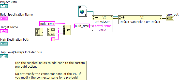

@plpablo wrote:
Thank You all for answers
Possible reason(s):
Oops.  Try this:
