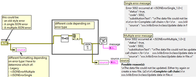

Error handling using ”Retain all errors”
The Merge Errors node can be set to retain all errors (right-click menu). But Simple Error Handler.vi is not smart enough to convert the errors to something readable and just outputs the JSON text. Why?
If I use “Convert to Legacy Error Cluster.vi”, the source text of a JSON error is not as in the original. Line feeds and carriage returns are replaced with \r\n. Why?
By using the Vis in the “Multiple Errors” subpalette, I can get the errors out again and I can get the errors in a readable format again. But I have to know what type of error I have or create code to find out. And then I need different code depending on the error type to get readable source text. And format that text myself.
Is there a replacement for Simple Error Handler to manage this?
Is there a better way to do this than to write my own error handler?
Shouldn’t there be a VI that detects and outputs what type of error I have at least, so I can determine what to do with the error? E.g. Legacy Single / Multiple.
I could not find much about it in the help, no example and nothing from googling.
The differentiation between single and multiple is just silly to me. 'Multiple' is an array, and a single element fits perfectly in an array. It just complicates things, without any advantage.
\vi.lib\MultiError\Is Encoded.vi returns true if it's an encoded error (Legacy vs Single\Multiple).
Error Cluster to Array of Errors.vi returns 1 or multiple errors (Single vs Multiple).
