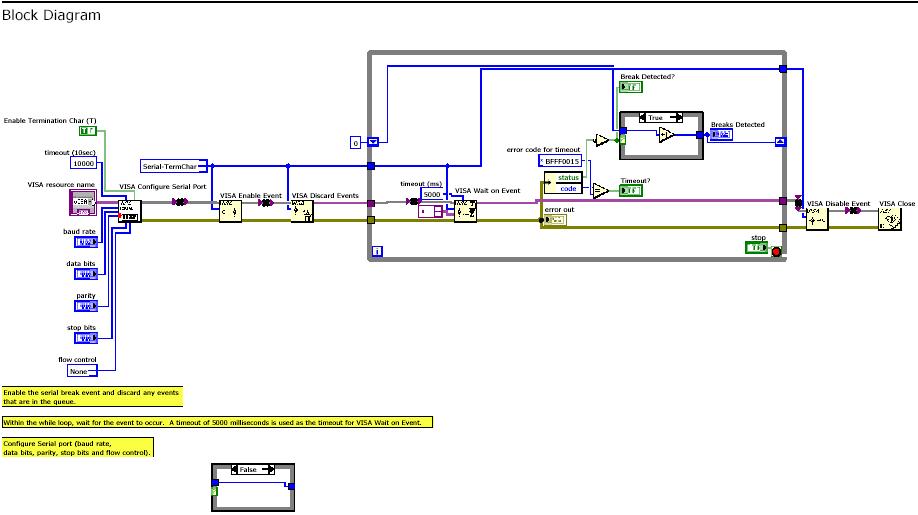

Hey friend,
As you can see i have just opened an example detect break event.vi.
The error is"Wite class conflict".
Please help me on this.
I have a program which uses thisVI.that program is showing the warning
" This VI needs a driver or toolkit component that is not found. Missing resource file "visarc"."
please help me on this.
(3,714 Views)
Do you have NI-VISA installed?
(3,701 Views)
yes i have NI-VISA . .
I am using 8.6 verision of LAbview
(3,690 Views)
Accepted by topic author dakudiv
Repaired Labview
