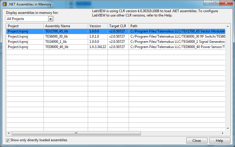

So in the development environment I can run my application just fine, Looking at the '.NET Assemblies in Memory' window shows me this:
Great.

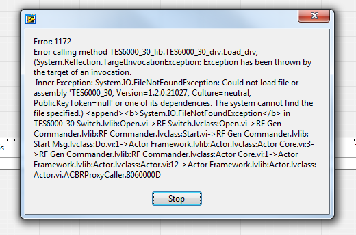

However when call the .NET LV code (by mouse click) I get the following message:
Not so great. (the error window is part of my own error handling)
I've tried copying the DLLs out of the data directory and to simply in the app directory but to no avail.
There can't be any other dependancies as they would show up in the .NET Assemblies in Memory window when in dev environment... right? Even so, Telemakus ship no other DLLs with their drivers so any other dependancy must be in the GAC I guess.
One thing that has foxed me is that the error points to missing version 1.2.0.21027 - this does not match the versions I see in the Assembles in Memory Window. Maybe something to do with it?

I can tell you for sure that if you specify the path in the app builder under Destination->Support Directory, this path will be searched under runtime conditions and the assembly will be found. It took us hours to figure out and it works like search path setting. We use an Visual Studio Installer to deploy the GAC registered LabVIEW InteropAssembly which calls 3rd party assemblies (GAC registered and unregistered with enclosed COM calls).
The other thing is the wrong version. Probably you work with different versions of the same DLL. You have to be sure to deploy the referenced version. If you have mixed calls (both versions referenced) to the RF switch assembly you should use a policy file to point to the latest version because you can't have both in the search path.

It must be a versioning issue then as the path is specified.
This is further backed up by the error showing me an errant version number.
What I don't understand is that these assemblies must be the correct version. To make sure, I copied the DLLs from their location shown in the project into the support directory.
Furthermore, the version numbers shown in the error have never been made by the manufacturer and are not even close to the ones shown in the .NET assemblies window.
Very confused.
