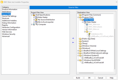

After a few more hours of searching I found the actual missing file.  The file causing the problem was nNIBlueBus_nCrioFixed.dll.  For LabVIEW 2025 this file needs to be present in c:\windows\Syatem32 and c:\windows\SysWOW64 for RIO functions to be used in executable.  Once the file was added to the installer build specifications Destination View under the two folders mentioned the program worked as expected on the target PC.  Only question I have now is why LabVIEW was unable to determine it would need this file when it is part of the NI RIO driver, I think?

Thanks For the reply Messenger2.  yes, similar to 2019 as you posted.  Workaround I found for 2025 was to add the files to locations shown in picture. This is where I found the files loaded on the development PC.  It does work though not certain it is the best solution.
For the question of driver revision, this should have been the same as on the development PC since I had my IT group only run the installer build and no other NI installers.  It is possible the installer did not build as expected I just don't know.  At least the workaround is working.
