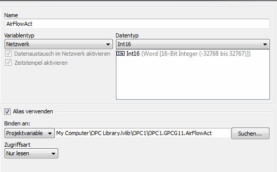

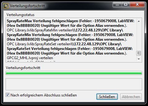

I am using the NI OPC server 2013 to connect LabVIEW 15 to a processing unit. That was working quite well, until I added another label to the server. I did not change anything in the configuration and repeated the step I used before from the NI document "Connect LabVIEW to any PLC using OPC". Since then I cannot deploy any bound variables in my library without getting the error shown in the following picture (in german):
The error code means "Invalid value for the Enable Aliasing option. On the Variable page of the Shared Variable Properties dialog box, verify the values of the options that are enabled when you place a checkmark in the Enable Aliasing checkbox."
I checked the Enable alias box and selected the variable from the drop down menu:

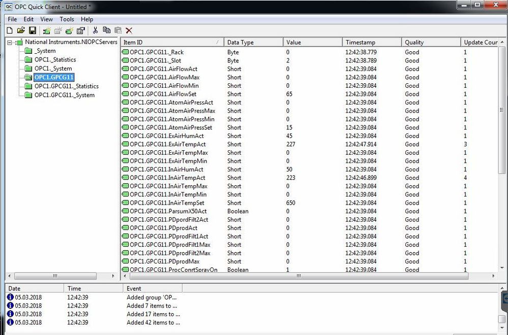

Also, the OPC server is comunicating with the equipment without any problems as seen in the screen capture of the quick client.
I removed all items from the library and added them again. That did not help. Du you guys have any suggestions?
