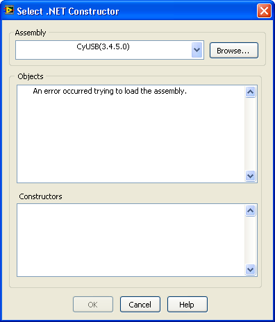

I am trying to load the CyUSB.dll into labVIEW using the .net constructor node. When I browse the CyUSB.dll file, the class window displays an error "An error occured trying to load the assembly."
A .net exe is being able to load the same file and run successfully without any errors..
Has anyone faced this before? Can anyone help me solve this issue? Any help would be highly appreciated..

Do you have the correct version of the .NET framework on your machine that corresponds to the version the .NET assembly was written for?

Hi Chris,
I was able to load the dll to the Contructor node. This issue was because the dll was being used by another application. When I closed it and tried loading it worked.
But the issue I'm facing now is not all the functions are accessible and from the programmers manul of CyUSB, I have found out that the USB Device List must be used to get the device communication working. But I'm having a tough time communicating with the device. The system throws an error when using the get_item function.
